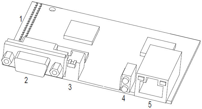

A.2.3 The appearance of EC-TX-103 communication card
Figure A‑1 Outline diagram of EC-TX-103 communication card
1. Interface to the panel
2. Bus connector
3. Rotation node address selection switches
4. State display LEDs
5. Ethernet communication interface

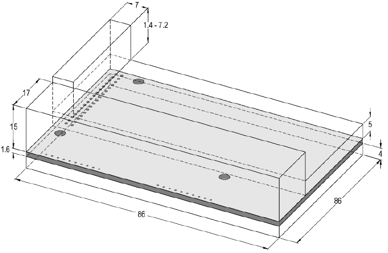

Figure A‑2 External dimensions of EC-TX-103 communication card (Unit: mm)

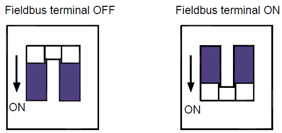

2. Bus terminals
There is a bus terminal in each heading and ending to avoid error during operation. The DIP switch on RPBA-01PCB is used to connect the bus terminals which can avoid the signal feedback from the bus cables. If the module is the first or last one in the internet, the bus terminal should be set as ON. Please disconnect EC-TX-103 communication card terminals when the PROFIBUS D-sub connector with internal terminals is in use.

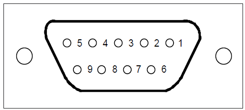

● Contact pin: 9 frames D pin, the connector contact pins are as below:
Contact pin of the connector
Instruction
1
Unused
2
Unused
3
B-Line
Positive data (twisted pair cables 1)
4
RTS
Sending requirement
5
GND_BUS
Isolation ground
6
+5 V BUS
Isolated 5 V DC power supply
7
Unused
8
A-Line
Negative data (twisted pair cables 2)
9
Unused
Housing
SHLD
PROFIBUS shielded cable

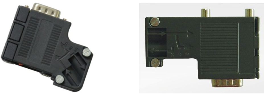

It is recommended to apply the standard DB9 connector of SIEMENS. If the communication baud rate is above 187.5kbps, please follow the connection rules of SIEMENS seriously.
                Available                                                                              Not available (with interference to the keypad wiring)

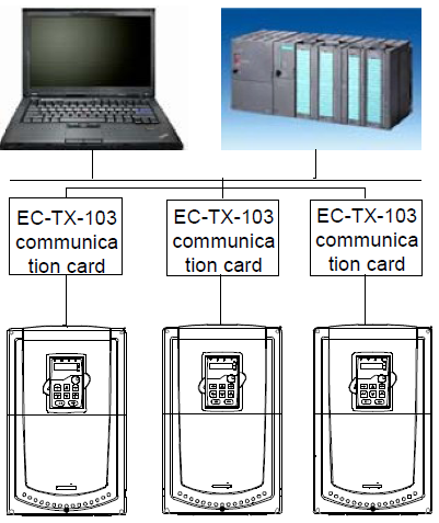

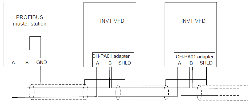

A.2.6.5 PROFIBUS bus connection diagram
Above is "terminal" wiring diagram. Cable is a standard PROFIBUS cable consisting of a twisted pair and shielding layer. The shielded layer of PROFIBUS cable on all nodes is directly grounded. Users can choose the best grounding method according to the situation.
Note:
1. Make sure that signal lines do not twist when connecting all stations. Shielded cable should be used when system runs under high electromagnetic interface environment, which can improve electromagnetic compatibility (EMC).
2. If using shielded braided wire and shielding foil, both ends should be connected to ground. Using shielding area should be large enough to maintain a good conductivity. And data lines must be separated from high-voltage.
3. Stub line segment should not be used when transmission rate more than 500K bit/s, The plug is available on the market which connects directly to data input and output cable. Bus plug connection can be on or off at any time without interruption of data communications of other station.

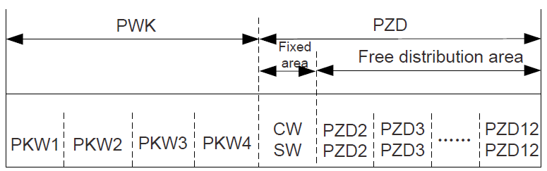

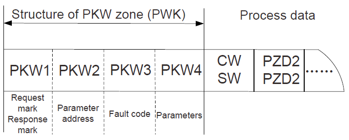

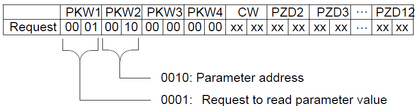

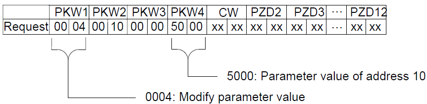

3. PROFIBUS -DP information frame data structure
PROFIBUS-DP bus mode allows rapid data exchange between master station and VFD. Adopting master-slave mode dealing with VFD access, VFD is always subsidiary station, and each has definite address. PROFIBUS periodic transmission messages use 16 words (16 bit) transmission, the structure shown in the following figure.
Parameters area:
PKW1-Parameter identification
PKW2-array index number
PKW3-parameter value 1
PKW4-parameter value 2
Process data:
CW-Control word (from master to slave, see "Control word (CW) of Goodrive35 series")
SW-state word (from slave to master, see "State word (SW) of Goodrive35 series")
PZD-process data (decided by users)
(From master to slave output 【given value】, from slave to master input【actual value】)
PZD area (process data area)
PZD area of communication message is designed for control and monitor VFD. PZD from master and slave stations is addressed in high priority; the priority of dealing with PZD is superior to that of PKW, and always sends current valid date from interface.

PKW area (parameter identification marks PKW1-value area). PKW area describes treatment of parameter identification interface, PKW interface is a mechanism which determine parameters transmission between two communication partners, such as reading and writing parameter values.
Parameter identification zone
In the process of periodic PROFIBUS-DP communication, PKW area is composed of four words (16 bit), each word is defined as follows:
The first   word PKW1 (16 bit)
Bit 15–00
Task or   response identification marks
0–7
The   second word PKW2 (16 bit)
Bit 15–00
Basic   parameters address
0–247
The third   word PKW3 (16 bit)
Bit 15–00
Parameter   value (high word) or return error code value
00
The   fourth word PKW4 (16 bit)
Bit 15–00
Parameter   value (low word)
0–65535

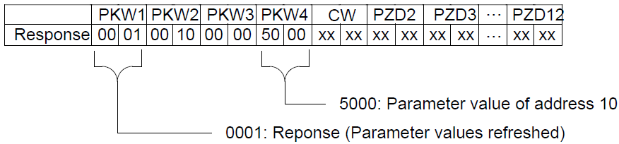

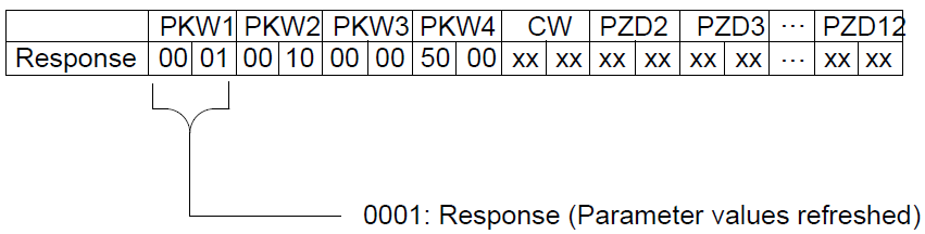

PKW examples:
Example 1: Read parameter value. Read keypad set frequency value (the address of keypad set frequency is 10) which can be achieved by setting PKW1 as 1, PKW2 as 10, return value is in PKW4.
Request (From the master to the VFD):
Response (From the VFD to the master)
Example 2: Modify the parameter values (RAM and EEPROM are modified). Modify keypad settings frequency value (the address of keypad set frequency is 10) which can be achieved by setting PKW1 as 4; PKW2 as 10, modification value (50.00) is in PKW4.

EC-TX-103 communication card is equipped with 2 fault display LEDs as shown is figure below. The roles of these LEDs are as follows:
Figure A‑3 Fault display LEDs
LED No.
Name
Color
Function
1
Online
Green
ON-module   online and data can be exchanged.
OFF-module   is not in "online" state.
2
Offline/Fault
Red
ON-module   offline and data can’t be exchanged.
OFF-module   is not in "offline" state.
1. Flicker   frequency 1 Hz-configuration error: The length of user parameter data sets is   different from that of network configuration process during module   initialization process.
2. Flicker   frequency 2 Hz-user parameter data error: The length or content of user   parameter data sets is different from that of network configuration process   during module initialization process.
3. Flicker   frequency 4 Hz-PROFIBUS communication ASIC initialization error.
4. OFF-Diagnostic   closed.
