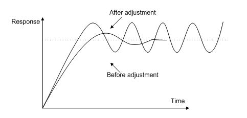

Proportional adjustment (Kp): when there is an error between the feedback and the reference, a proportional adjustment will be output. If the error is constant, the adjustment will be constant, too. Proportional adjustment can respond to the feedback change quickly, but it cannot realize non-fault control. The gain will increase with the adjustment speed, but too much gain may cause vibration. The adjustment method is: set a long integral time and derivative time to 0 first. Secondly make the system run by proportional adjustment and change the reference. And then watch the error of the feedback signal and the reference. If the static error is available (for example, increasing the reference, the feedback will be less than the reference after a stable system), continue to increase the gain, vice versa. Repeat the action until the static error achieves a little value.
Integral time (Ti): the output adjustment will accumulate if there is an error between the feedback and the reference. The adjustment will keep on increasing until the error disappears. If the error is existent all the time, the integration adjustor can cancel the static error effectively. Vibration may occur as a result of unstable system caused by repeated over-adjustment if the integration adjustor is too strong. The features of this kind of vibration are: the fluctuating feedback signal (around the reference) and increasing traverse range will cause vibration. Adjust the integral time parameter from a big value to a little one to change the integral time and monitor the result until a stable system speed is available.

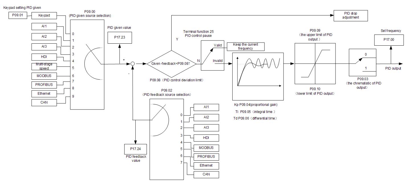

When P00.06, P00. 07=7 or P04.27=6, the running mode of the VFD is procedure PID control.

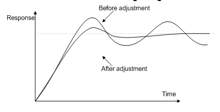

Control the overshoot
Shorten the derivative time and prolong the integral time when overshoot occurs.

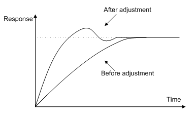

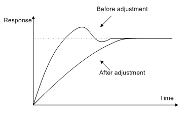

Achieve the stable state as soon as possible
Shorten the integral time (Ti) and prolong the derivative time (Td) even the overshoot occurs, but the control should be stable as soon as possible.
Control long vibration
If the vibration periods are longer than the set value of integral time (Ti), it is necessary to prolong the integral time (Ti) to control the vibration for the strong integration.

Related parameters list:
Function code
Name
Detailed instruction of parameters
Default value
P09.00
PID reference source
0: Keypad (P09.01)
1: AI1
2: AI2
3: AI3
4: HDI
5: Multi-step speed set
6: MODBUS communication set
7: PROFIBUS/CANopen communication set
8: Ethernet communication set
9: Reserved
0
P09.01
Keypad PID preset
-100.0%–100.0%
0.0%
P09.02
PID feedback source
0: AI1
1: AI2
2: AI3
3: HDI
4: MODBUS communication feedback
5: PROFIBUS/CANopen communication feedback
6: Ethernet communication feedback
7: Reserve
0
P09.03
PID output feature
0: PID output is positive
1: PID output is negative
0
P09.04
Proportional gain (Kp)
0.00–100.00
1.00
P09.05
Integral time (Ti)
0.00–10.00s
0.10s
P09.06
Differential time (Td)
0.00–10.00s
0.00s
P09.07
Sampling cycle (T)
0.000–10.000s
0.100s
P09.08
PID control deviation limit
0.0–100.0%
0.0%
P09.09
Output upper limit of PID
P09.10–100.0% (max frequency or max voltage)
100.0%
P09.10
Output lower limit of PID
-100.0%–P09.09 (max frequency or max voltage)
0.0%
P09.11
Detection value of feedback offline
0.0–100.0%
0.0%
P09.12
Detection time of feedback offline
0.0–3600.0s
1.0s
P09.13
PID adjustment
0x0000–0x1111
LED ones:
0: Keep on integral adjustment when the frequency achieves the upper and low limit; the integration shows the change between the reference and the feedback unless it reaches the internal integral limit. When the trend between the reference and the feedback changes, it needs more time to offset the impact of continuous working and the integration will change with the trend.
1: Stop integral adjustment when the frequency achieves the upper and low limit. If the integration keeps stable, and the trend between the reference and the feedback changes, the integration will change with the trend quickly.
LED tens: P00.08 is 0
0: The same with the setting direction; if the output of PID adjustment is different from the current running direction, the internal will output 0 forcedly.
1: Opposite to the setting direction
LED hundreds: P00.08 is 0
0: Limit to the maximum frequency
1: Limit to frequency A
LED thousands:
0: A+B frequency, the buffer of A frequency is invalid
1: A+B frequency, the buffer of A frequency is valid
ACC/DEC is determined by ACC time 4 of P08.04
0x0001
P17.00
Setting frequency
0.00Hz–P00.03 (the max frequency)
0.00Hz
P17.23
PID reference
-100.0–100.0%
0.0%
P17.24
PID feedback
-100.0–100.0%
0.0%
