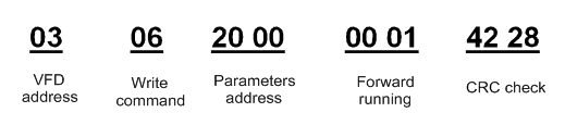

10.4.5.2 The address instruction of other function in Modbus
The master can operate on the parameters of the VFD as well as control the VFD, such as running or stopping and monitoring the working state of the VFD.
Below is the parameter list of other functions:
Function instruction | Address definition | Data meaning instruction | R/W attribute |
Communication control command | 2000H | 0001H: forward running | W/R |
0002H: reverse running | |||
0003H: forward jogging | |||
0004H: reverse jogging | |||
0005H: stop | |||
0006H: coast to stop | |||
0007H: fault reset | |||
0008H: jogging stop | |||

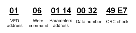

If Modbus communication is used to control the hibernation restore delay time as 5.0s. Firstly, 5.0 can be magnified by 10 times to integer 50 (32H) and then this data can be sent.
After the VFD receives the command, it will change 50 into 5 according to the fieldbus ratio value and then set the hibernation restore delay time as 5s.

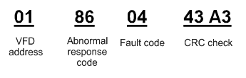

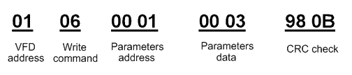

For example, set the “running command channel” of the VFD (P00.01, parameter address is 0001H) with the address of 01H to 03, the command is as following:
But the setting range of “running command channel” is 0–2, if it is set to 3, because the number is beyond the range, the VFD will return fault response message as below:
Abnormal response code 86H means the abnormal response to writing command 06H; the fault code is 04H. In the table above, its name is operation failed and its meaning is that the parameter setting in parameter writing is invalid. For example, the function input terminal cannot be set repeatedly.

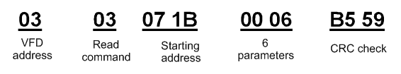

Watch “Type of the present fault” to “Type of the last but four fault” of the VFD through commands, the corresponding function code is P07.27–P07.32 and corresponding parameter address is 071BH–0720H (there are 6 from 071BH).
The command sent to the VFD:

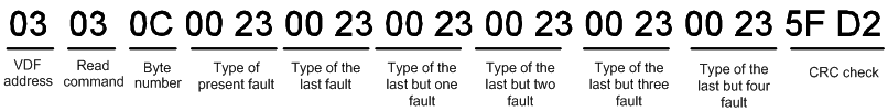

If the response message is as below:
See from the returned data, all fault types are 0023H (decimal 35) with the meaning of maladjustment (STo).

Make the VFD with the address of 03H to run forward. See table 1, the address of “communication control command” is 2000H and forward running is 0001. See the table below.
Function instruction | Address definition | Data meaning instruction | R/W characteristics |
Communication control command | 0001H: forward running | W/R | |
0005H: stop | |||
0006H: coast to stop (emergency stop) | |||
The command sent by the master:
If the operation is success, the response may be as below (the same with the command sent by the master):

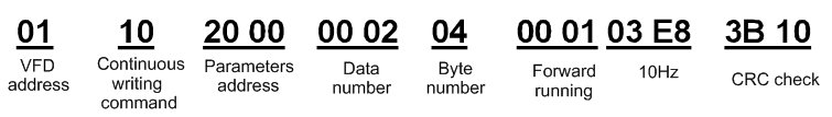

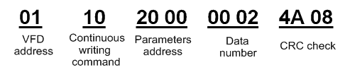

Example 1: make the VFD whose address is 01H run forward at 10Hz. Refer to the instruction of 2000H and 0001. Set the address of “communication setting frequency” is 2001H and 10Hz corresponds to 03E8H. See the table below.
0005H: stop | |||
The address of communication setting | 2001H | Communication setting frequency (0–Fmax (unit: 0.01Hz)) | W/R |
2002H | PID given, range (0–1000, 1000 corresponds to100.0%) |
Set P00.01 to 2 and P00.06 to 8.
