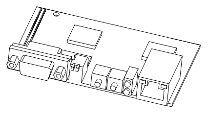

EC-TX-103 communication card is an optional device to VFD which makes VFD connected to PROFIBUS network. In PROFIBUS network, VFD is a subsidiary device. The following functions can be completed using EC-TX-103 communication card:

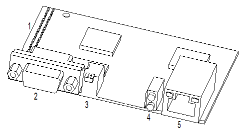

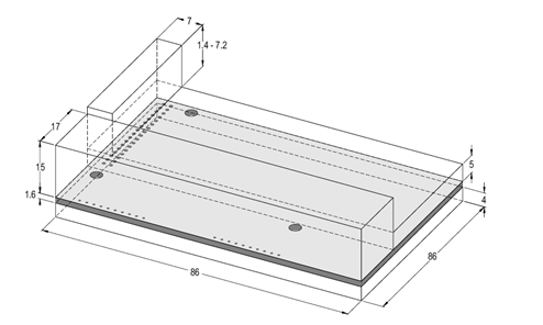

Outline diagram of EC-TX-103 communication card
1. Interface to the panel; 2. Bus connector; 3. Rotation node address selection switches; 4. State display LEDs
External dimensions of EC-TX-103 communication card (Unit: mm)

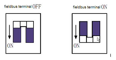

● Set the bus terminal switch of the module to the needed location.

2. Bus terminals
There is a bus terminal in each heading and ending to avoid error during operation. The DIP switch on RPBA-01PCB is used to connect the bus terminals which can avoid the signal feedback from the bus cables. If the module is the first or last one in the internet, the bus terminal should be set as ON. Please disconnect EC-TX-103 communication card terminals when the PROFIBUS D-sub connector with internal terminals is in use.

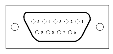

● Contact pin: 9 frames D pin, the connector contact pins are as below:
Contact pin of the connector | Instruction | |
1 | - | Unused |
2 | - | Unused |
3 | B-Line | Positive data (twisted pair cables 1) |
4 | RTS | Sending requirement |
5 | GND_BUS | Isolation ground |
6 | +5V BUS | Isolated 5V DC power supply |
7 | - | Unused |
8 | A-Line | Negative data (twisted pair cables 2) |
9 | - | Unused |
Housing | SHLD | PROFIBUS shielded cable |
+5V and GND_BUS are used in the fieldbus terminals. Some devices, such as light transceiver (RS485) may get external power supply from these pins.
RTS is used in some devices to determine the sending direction. Only A-Line wires, B-Line wires and shield are used in the normal application.

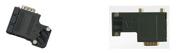

It is recommended to apply the standard DB9 connector of SIEMENS. If the communication baud rate is above 187.5kbps, please follow the connection rules of SIEMENS seriously.

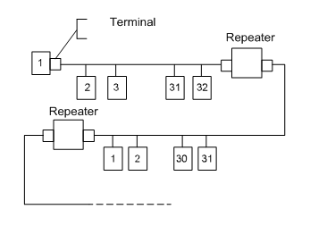

Repeater
Up to 32 stations can be connected to each segment (master station or subsidiary stations), the repeater have to be used when stations is more than 32. The repeaters in series are generally no more than 3.
Note: There is no repeater station address.

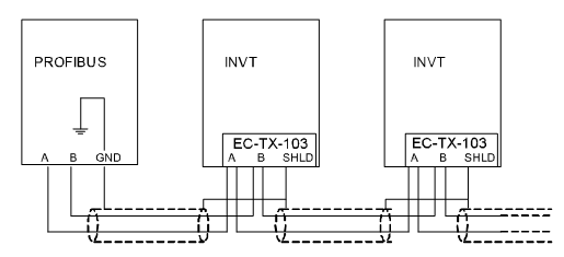

A.2.6.5 PROFIBUS bus connection diagram
Above is "terminal" wiring diagram. Cable is a standard PROFIBUS cable consisting of a twisted pair and shielding layer. The shielded layer of PROFIBUS cable on all nodes is directly grounded. Users can choose the best grounding method according to the situation.
Note:
Make sure that signal lines do not twist when connecting all stations. Shielded cable should be used when system runs under high electromagnetic interface environment, which can improve electromagnetic compatibility (EMC).
If using shielded braided wire and shielding foil, both ends should be connected to ground. Using shielding area should be large enough to maintain a good conductivity. And data lines must be separated from high-voltage.
Stub line segment should not be used when transmission rate more than 500K bit/s, The plug is available on the market which connects directly to data input and output cable. Bus plug connection can be on or off at any time without interruption of data communications of other station.

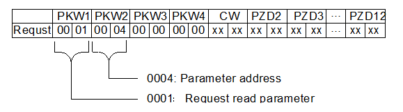

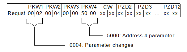

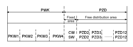

3. PROFIBUS-DP information frame data structures
PROFIBUS-DP bus mode allows rapid data exchange between master station and VFD. Adopting master-slave mode dealing with VFD access, VFD is always subsidiary station, and each has definite address. PROFIBUS periodic transmission messages use 16 words (16 bit) transmission, the structure shown in figure1.
Parameters area:
PKW1-Parameter identification
PKW2-array index number
PKW3-parameter value 1
PKW4-parameter value 2
Process data:
CW-Control word (from master to slave)
SW-state word (from slave to master)
PZD-process data (decided by users) (From master to slave output 【given value】, from slave to master input【actual value】)
PZD area (process data area)

PKW area (parameter identification marks PKW1-value area). PKW area describes treatment of parameter identification interface, PKW interface is a mechanism which determine parameters transmission between two communication partners, such as reading and writing parameter values.
In the process of periodic PROFIBUS-DP communication, PKW area is composed of four words (16 bit), each word is defined as follows:
The first word PKW1 (16 bit) | ||
Bit 15–00 | Task or response identification marks | 0–7 |
The second word PKW2 (16 bit) | ||
Bit 15–00 | Basic parameters address | 0–247 |
The third word PKW3 (16 bit) | ||
Bit 15–00 | Parameter value (high word) or return error code value | 00 |
The fourth word PKW4 (16 bit) | ||
Bit 15–00 | Parameter value (low word) | 0–65535 |

Example 1: Read parameter value
Read keypad set frequency value (the address of keypad set frequency is 4) which can be achieved by setting PKW1 as 1, PKW2 as 4, return value is in PKW4.
Request (From master to VFD):
Response (From VFD to master)
Example 2: Modify the parameter values (RAM and EEPROM are modified)
Modify keypad settings frequency value (the address of keypad set frequency is 4) which can be achieved by setting PKW1 as 2; PKW2 as 4, modification value (50.00) is in PKW4.

EC-TX-103 communication card is equipped with 2 fault display LEDs as shown is figure below. The roles of these LEDs are as follows:
Fault display LEDs
LED No. | Name | Color | Function |
2 | Online | Green | ON-module online and data can be exchanged. OFF-module is not in "online" state. |
4 | Offline/Fault | Red | ON-module offline and data can’t be exchanged. OFF-module is not in "offline" state. 1. Flicker frequency 1Hz-configuration error: The length of user parameter data sets is different from that of network configuration process during module initialization process. 2. Flicker frequency 2Hz-user parameter data error: The length or content of user parameter data sets is different from that of network configuration process during module initialization process. 3. Flicker frequency 4Hz-PROFIBUS communication ASIC initialization error. 4. OFF-Diagnostic closed. |
