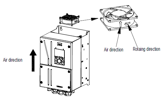

5. Install a new fan in the VFD in the reverse steps. Assemble the VFD. Ensure that the air direction of the fan is consistent with that of the VFD, as shown in the Fig 8.1.
6. Power on the VFD.
Figure 8–1 Fan maintenance for VFDs of 7R5G/011P or higher
