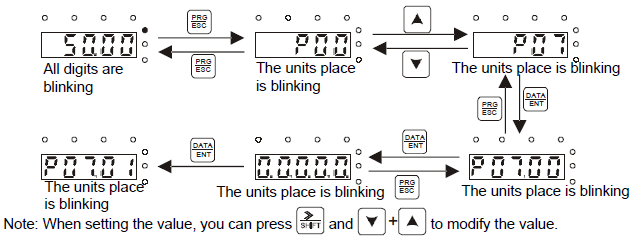

5.4.2 How to set the password of the VFD
Goodrive35 series VFDs provide password protection function to users. Set P7.00 to gain the password and the password protection becomes valid instantly after quitting from the function code editing state. Press PRG/ESC again to the function code editing state, "0.0.0.0.0" will be displayed. Unless using the correct password, the operators cannot enter it.
Set P7.00 to 0 to cancel password protection function.
The password protection becomes effective instantly after retreating from the function code editing state. Press PRG/ESC again to the function code editing state, "0.0.0.0.0" will be displayed. Unless using the correct password, the operators cannot enter it.
Figure 5‑4 Sketch map of password setting

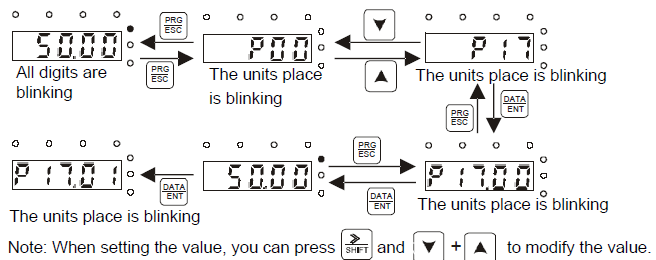

5.4.3 How to watch the VFD state through function codes
Goodrive35 series VFDs provide group P17 as the state inspection group. Users can enter into P17 directly to watch the state.
Figure 5‑5 Sketch map of state watching
