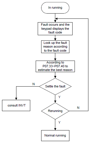

Goodrive35 series VFDs provide sufficient fault procedure information for the convenience of user’s application.
Relative parameters list:
