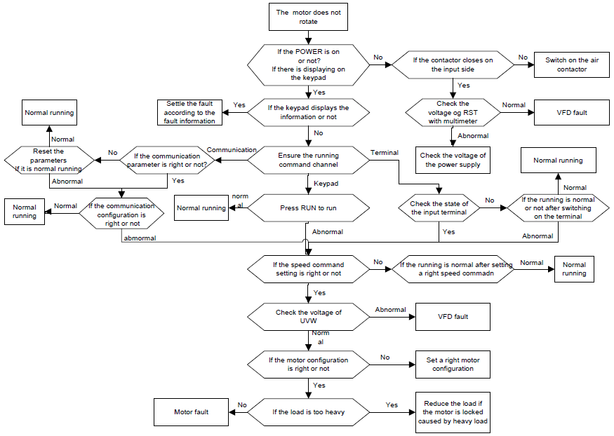

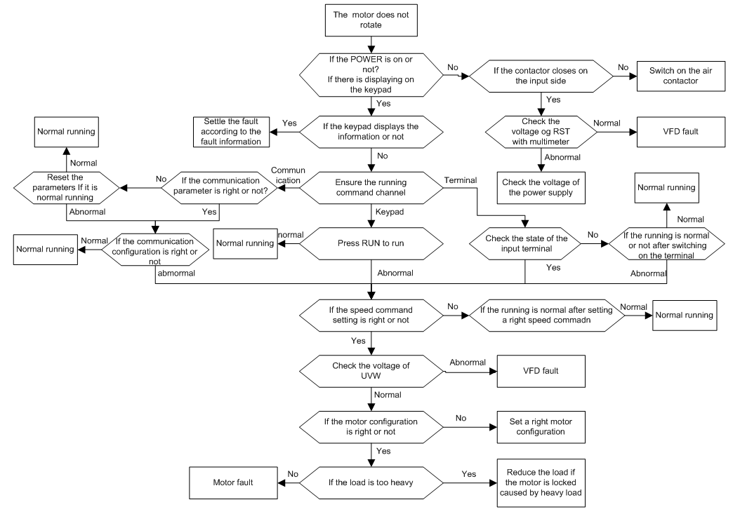

8.6.1 The motor does not work

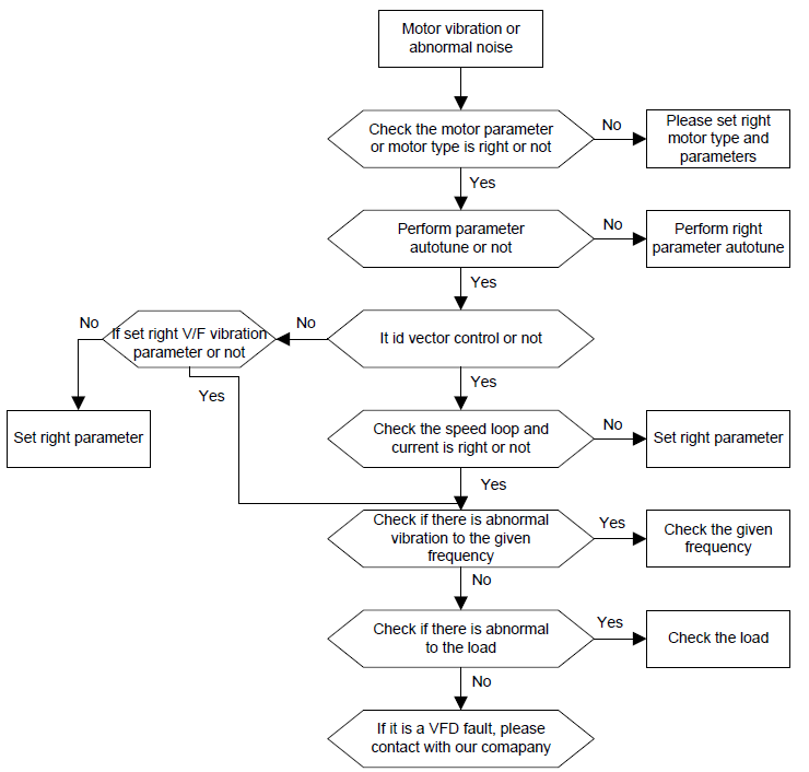

8.6.2 Motor vibration

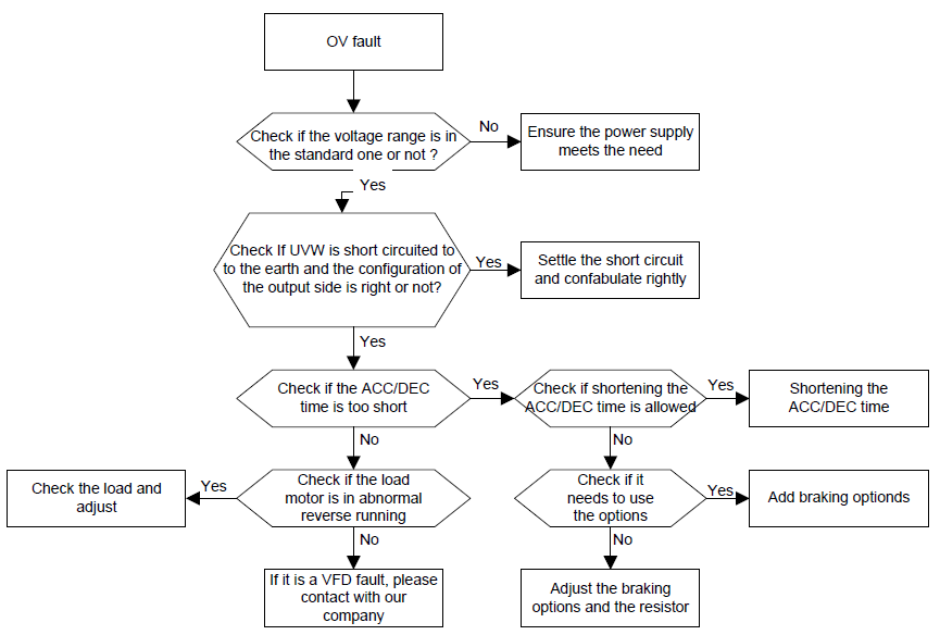

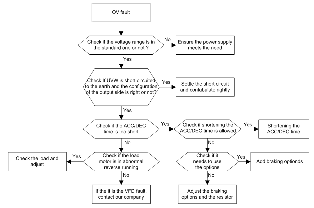

8.6.3 Overvoltage

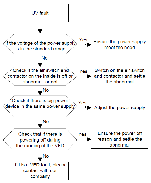

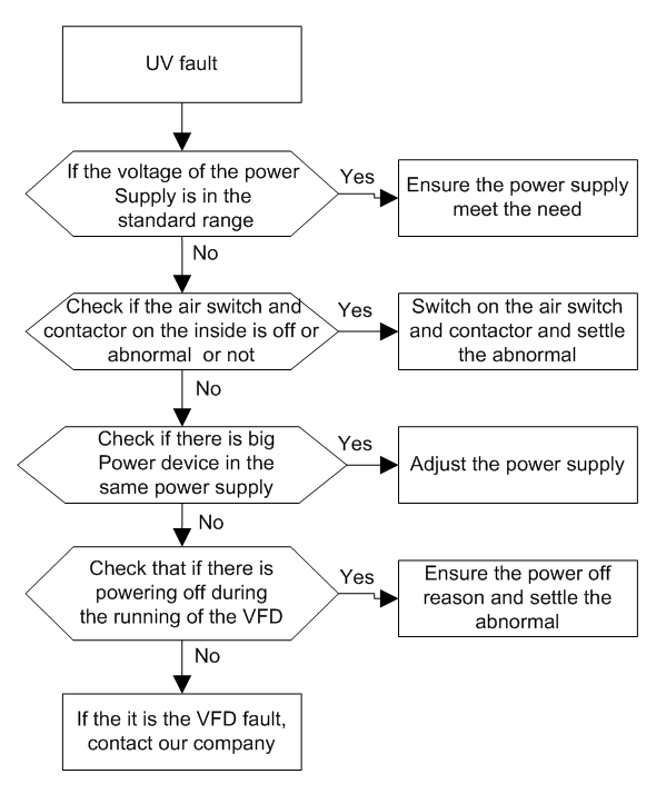

8.6.4 Undervoltage fault

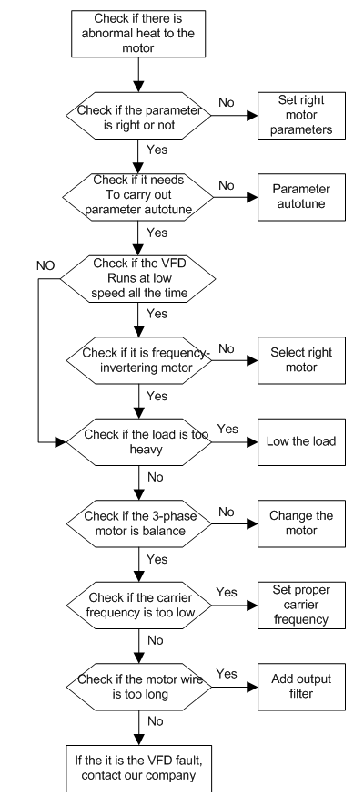

8.6.5 Abnormal heating of the motor

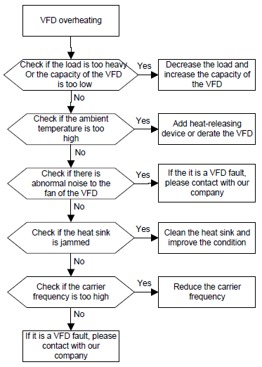

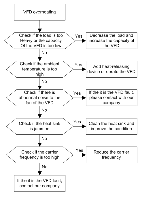

8.6.6 Overheat of the VFD

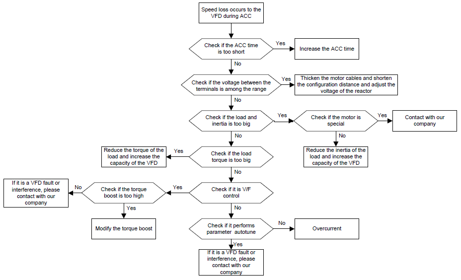

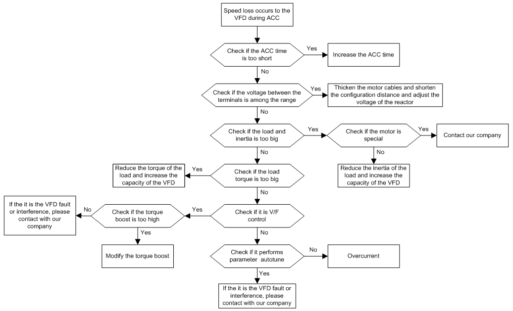

8.6.7 Motor stall during ACC

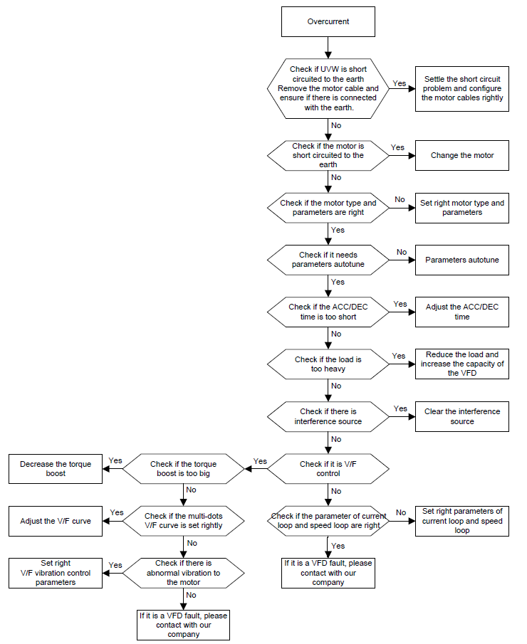

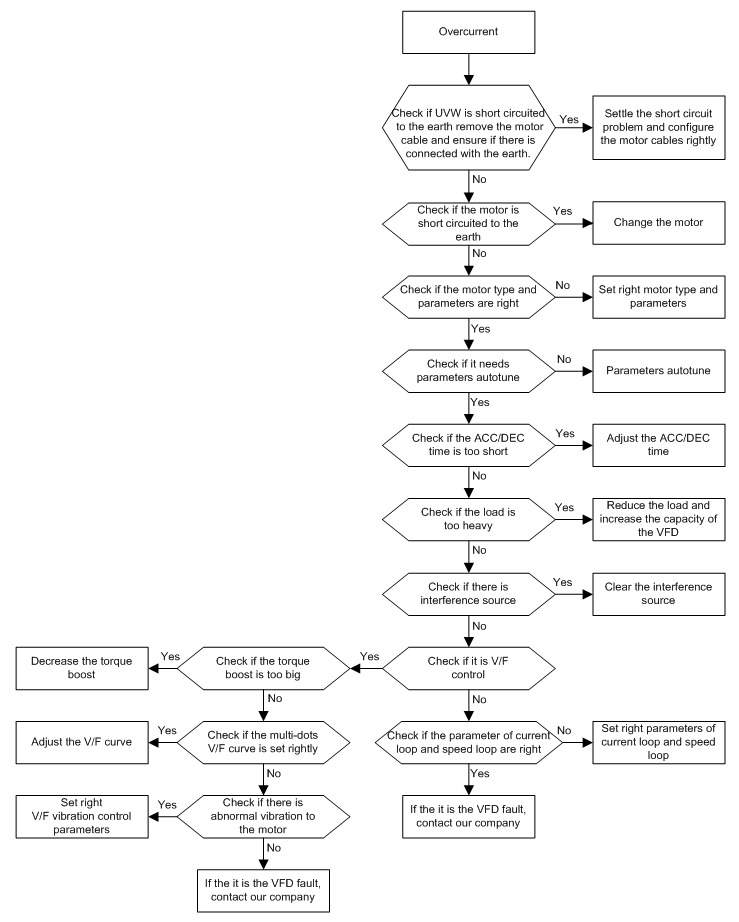

8.6.8 Overcurrent
