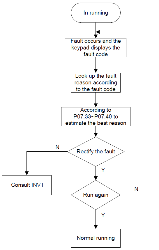

Goodrive300 series VFDs provide sufficient fault procedure information for the convenience of user’s application.

P07.27 | Type of current fault | 0: No fault 1: Inverter unit U phase protection (OUt1) 2: Inverter unit V phase protection (OUt2) 3: Inverter unit W phase protection (OUt3) 4: OC1 5: OC2 6: OC3 7: OV1 8: OV2 9: OV3 10:UV 11: Motor overload (OL1) 12:The VFD overload (OL2) 13: Input side phase loss (SPI) 14: Output side phase loss (SPO) 15: Overheat of the rectifier module (OH1) 16: Overheat fault of the inverter module (OH2) 17: External fault (EF) 18: 485 communication fault (CE) 19:Current detection fault (ItE) 20: Motor antotune fault (tE) 21: EEPROM operation fault (EEP) 22: PID response offline fault (PIDE) 23:Braking unit fault (bCE) 24: Running time arrival (END) 25: Electrical overload (OL3) 26: Panel communication fault (PCE) 27: Parameter uploading fault (UPE) 28: Parameter downloading fault (DNE) 29: PROFIBUS communication fault (E-DP) 30: Ethernet communication fault (E-NET) 31: CANopen communication fault (E-CAN) 32:Grounding short circuit fault 1 (ETH1) 33:Grounding short circuit fault 2 (ETH2) 34:Speed deviation fault (dEu) 35: Maladjustment (STo) 36: Undervoltage fault (LL) | 0 |

P07.33 | Running frequency at current fault | 0.00Hz | |
P07.34 | Ramp reference frequency at current fault | 0.00Hz | |
P07.35 | Output voltage at current fault | 0V | |
P07.36 | Output current at current fault | 0.0A | |
P07.37 | Bus voltage at current fault | 0.0V | |
P07.38 | The Max. temperature at current fault | 0.0°C | |
P07.39 | Input terminals state at current fault | 0 | |
P07.40 | Output terminals state at current fault | 0 | |
