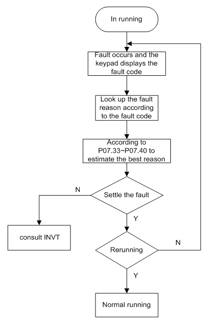

Goodrive310-UL series VFDs provide sufficient fault procedure information for the convenience of user’s application.
Related parameters list:
