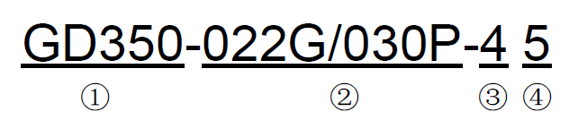

The model code contains product information. Users can find the model code on the nameplate and simple nameplate of the VFD.
Figure 3–4 Model code
Field
Sign
Description
Contents
Product Category
Abbreviation of product series
GD350: Goodrive350 high-performance multi-function VFD
Rated power
Power range + load type
022/030: 22kW
G: Constant torque load
P: Fan and water pump
Voltage level
Voltage level
4: AC 3PH 380V (-15%)–440V (+10%)
Rated voltage: 380V
Ingress   protection rating
5: IP54 ingress protection rating (It is   impossible to completely prevent dust from entering, but the amount of dust   from entering will not cause damage to the equipment; it will not cause   damage when the product is immersed in water from each direction).
