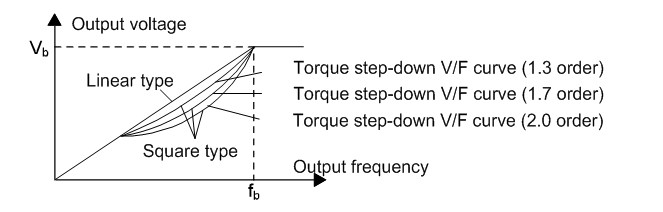

For the load of constant torque, such as the conveyor belt which runs linearly, it is proper to select linear V/F curve because it needs constant torque.
For the load of decreasing torque, such as fans and water pumps, it is proper to select corresponding 1.3th, 1.7th or 2th power of V/F curve because the actual torque is 2-squared or 3-squared of the rotating speed.

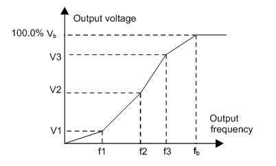

Goodrive310-UL series VFDs provide multi-dots V/F curve, the user can change the output V/F curve by setting the voltage and frequency of three middle dots. The whole curve consists of 5 dots. The starting dot is (0Hz, 0V), and the ending dot is (the basic frequency of the motor, the rated voltage of the motor). During the setting processing: 0≤f1≤f2≤f3≤the basic frequency of the motor; 0≤V1≤V2≤V3≤the rated voltage of the motor.

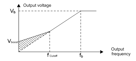

1. Torque boost
Torque boost function can compensate the performance of low speed torque during SVPWM control. The VFD will adjust the torque boost according to the actual load.
Note:
The torque boost takes effect only when the frequency is under the cap frequency of the boost.
If the torque boost is too big, low frequency vibration or overcurrent fault may occur. Please lower the torque boost.

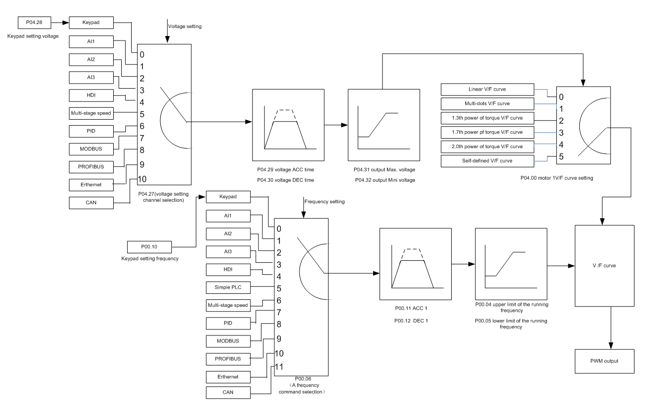

5. User-defined V/F curve (V/F separation) function
When the user selects the user-defined V/F curve function in Goodrive310-UL series VFDs, they can set the given channel of voltage and frequency and the corresponding ACC/DEC time, or the two can combine to form a real-time curve.

P04.00 | Motor 1V/F curve setting | 0: Straight line V/F curve; applying to the constant torque load 1: Multi-dots V/F curve 2: 1.3th power low torque V/F curve 3: 1.7th power low torque V/F curve 4: 2.0th power low torque V/F curve 5: Customized V/F (V/F separation) | 0 |

P04.27 | Voltage setting | 0: Keypad: the output voltage is determined by P04.28. 1: AI1 ; 2: AI2; 3: AI3; 4: HDI; 5: Multi-step speed; 6: PID; 7: MODBUS communication; 8: PROFIBUS/CANopen communication; 9: Ethernet communication; 10: Reserved | 0 |
P04.28 | Keypad setting voltage | 0.0%–100.0% (rated motor voltage) | 100.0% |
P04.29 | Voltage increasing time | 0.0–3600.0s | 5.0s |
P04.30 | Voltage decreasing time | 0.0–3600.0s | 5.0s |
P04.31 | Maximum output voltage | P04.32–100.0% (rated motor voltage) | 100.0% |
P04.32 | Minimum output voltage | 0.0%–P04.31 (rated motor voltage) | 0.0% |
